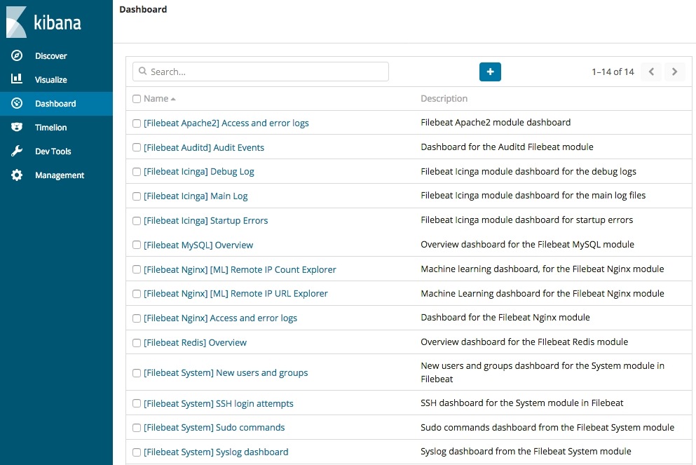

Go to the Dashboard page and select the dashboard that you want to open.
Navigation widget in Kibana

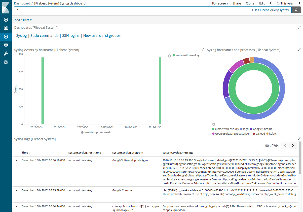

Here is an example of the Filebeat system dashboard:
kibana system
