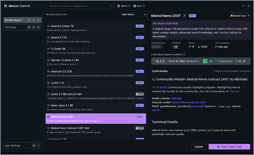

  1. Go to LM Studio’s Search window.
  2. Search for an LLM (for example, Mistral-Nemo-Instruct-2407). Your chosen model must include instruct in its name in order to work with Elastic.
  3. After you find a model, view download options and select a recommended version (green). For best performance, select one with the thumbs-up icon that indicates good performance on your hardware.
  4. Download one or more models.
For security reasons, before downloading a model, verify that it is from a trusted source. It can be helpful to review community feedback on the model (for example using a site like Hugging Face).
The LM Studio model selection interface
In this example we used mistralai/Mistral-Nemo-Instruct-2407. It has 12B total parameters, a 128,000 token context window, and uses GGUF quanitization. For more information about model names and format information, refer to the following table.

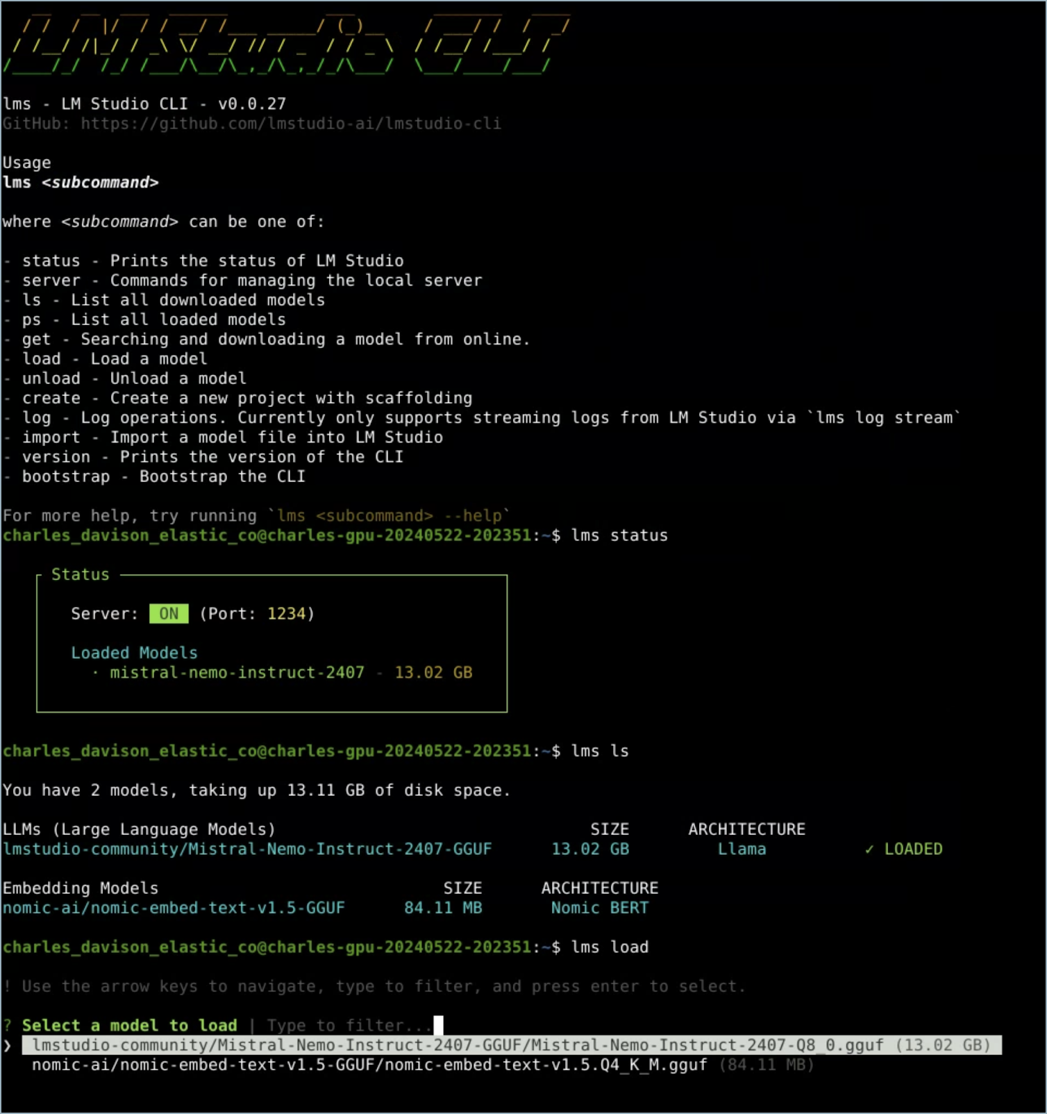

Once you’ve downloaded a model, use the following commands in your CLI:
  1. Verify LM Studio is installed: lms
  2. Check LM Studio’s status: lms status
  3. List all downloaded models: lms ls
  4. Load a model: lms load.
The CLI interface during execution of initial LM Studio commands

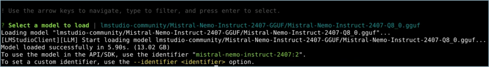

After the model loads, you should see a Model loaded successfully message in the CLI. Select a model using the arrow and Enter keys.
The CLI message that appears after a model loads

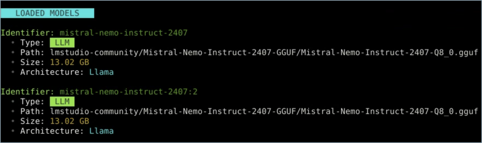

To verify which model is loaded, use the lms ps command.
The CLI message that appears after running lms ps
