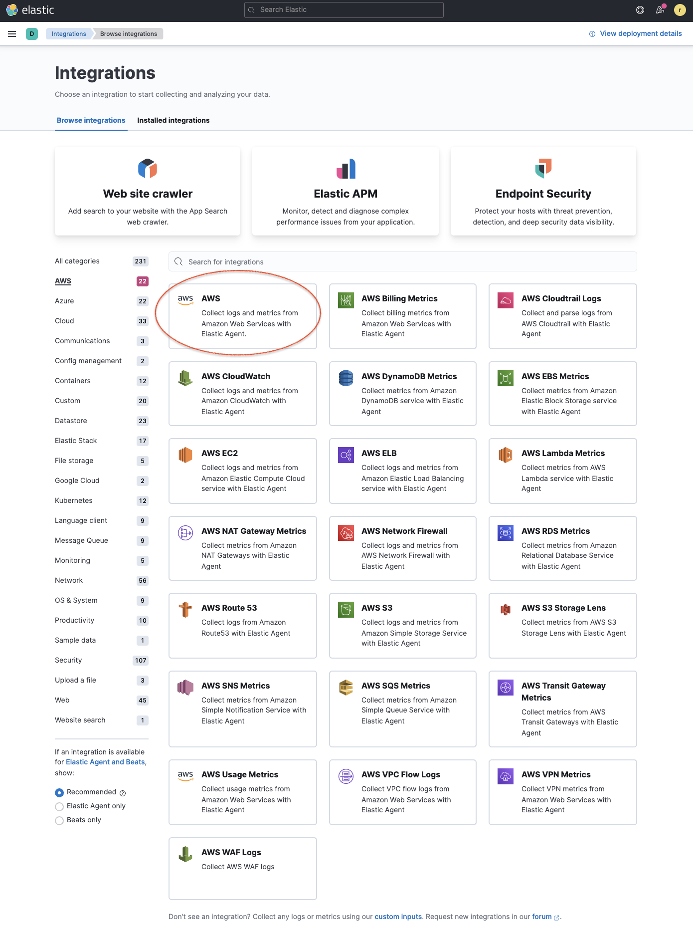

Install AWS integration assets in Kibanaedit
  1. Go to Integrations in Kibana and search for AWS (or select the AWS category to filter the list).
  2. Click the AWS integration, select Settings and click Install AWS assets and confirm to install all the AWS integration assets.
Find and install AWS integration assets in Kibana
Adding integrations from Kibana provides appropriate pre-built dashboards, ingest node configurations, and other assets that help you get the most out of the data you ingest. The integrations use data streams with specific naming conventions that provide you with more granular controls and flexibility on managing data ingestion.

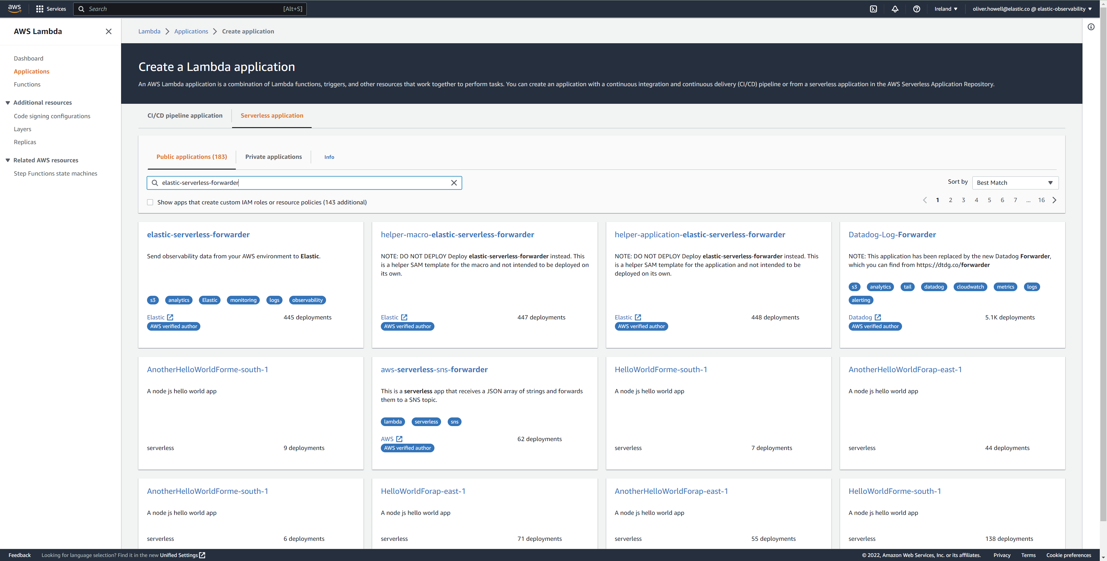

Deploy using AWS Consoleedit
  1. Log in to AWS console and open Lambda.
  2. Click Applications and then Create application.
  3. Click Serverless application and search for elastic-serverless-forwarder.
  4. Select elastic-serverless-forwarder from the search results (ignoring any application beginning helper-).
    Create Elastic Serverless Forwarder Lambda function within SAR
  5. Complete the Application settings according to Define deployment parameters
  6. After your settings have been added, click Deploy.
  7. On the Applications page for serverlessrepo-elastic-serverless-forwarder, click Deployments.
  8. Refresh the Deployment history until you see the Create complete status update. It should take around 5 minutes to deploy — if the deployment fails for any reason, the create events will be rolled back and you will be able to see an explanation for which event failed.
