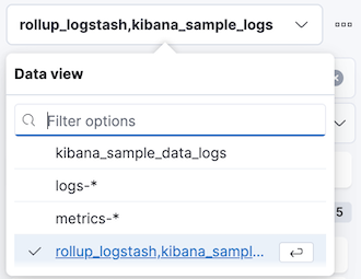

- Open the main menu, then click Stack Management > Data Views.
- Click Create data view, and select Rollup data view from the dropdown.
Enter rollup_logstash,kibana_sample_logs as your Data View and
@timestamp
as the Time Filter field name.The notation for a combination data view with both raw and rolled up data is
rollup_logstash,kibana_sample_data_logs
. In this data view,rollup_logstash
matches the rollup index andkibana_sample_data_logs
matches the raw data. - Open the main menu, click Dashboard, then Create dashboard.
- Set the time filter to Last 90 days.
- On the dashboard, click Create visualization.
Choose
as your source to see both the raw and rolled up data. - Select Bar vertical stacked in the chart type dropdown.
