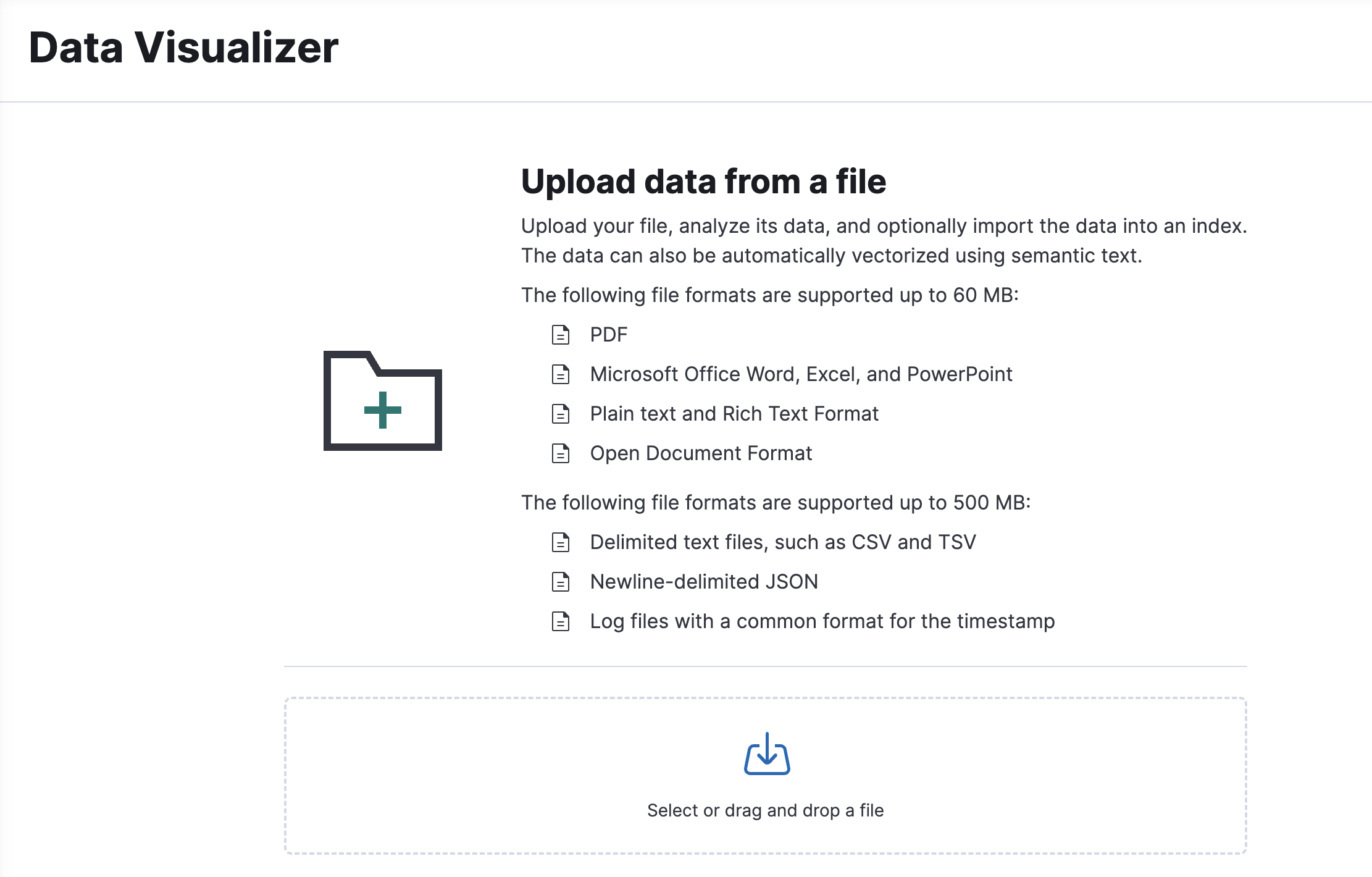

Upload a fileedit
[experimental] This functionality is experimental and may be changed or removed completely in a future release. Elastic will take a best effort approach to fix any issues, but experimental features are not subject to the support SLA of official GA features. If your data is in a CSV, JSON, or log file, you can upload it using the File Data Visualizer. You can upload a file up to 100 MB. This value is configurable up to 1 GB in Advanced Settings. To upload a file with geospatial data, refer to Import geospatial data.
This feature is not intended for use as part of a repeated production process, but rather for the initial exploration of your data.
