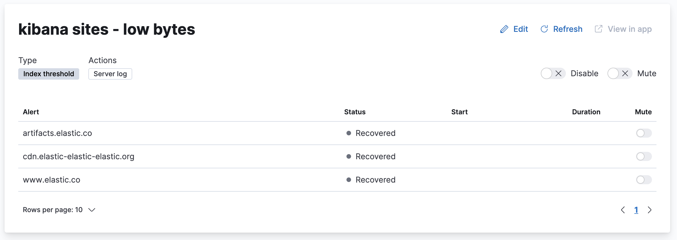

Rules in Stack Management lists the rules available in the space you’re currently in. When you click a rule name, you are navigated to the details page for the rule, where you can see currently active alerts. The start date on this page indicates when a rule is triggered, and for what alerts. In addition, the duration of the condition indicates how long the instance is active.
Alerting management details

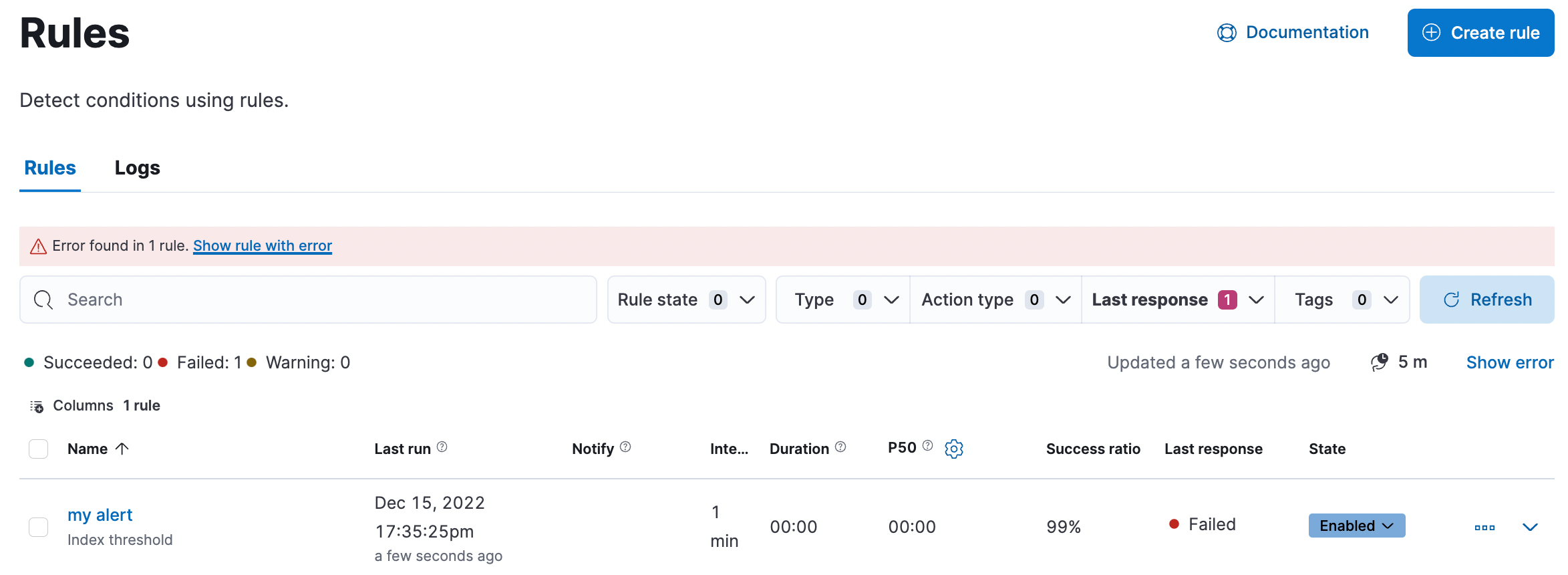

The Stack Management > Rules page contains an error banner that helps to identify the errors for the rules:
Rule management page with the errors banner
