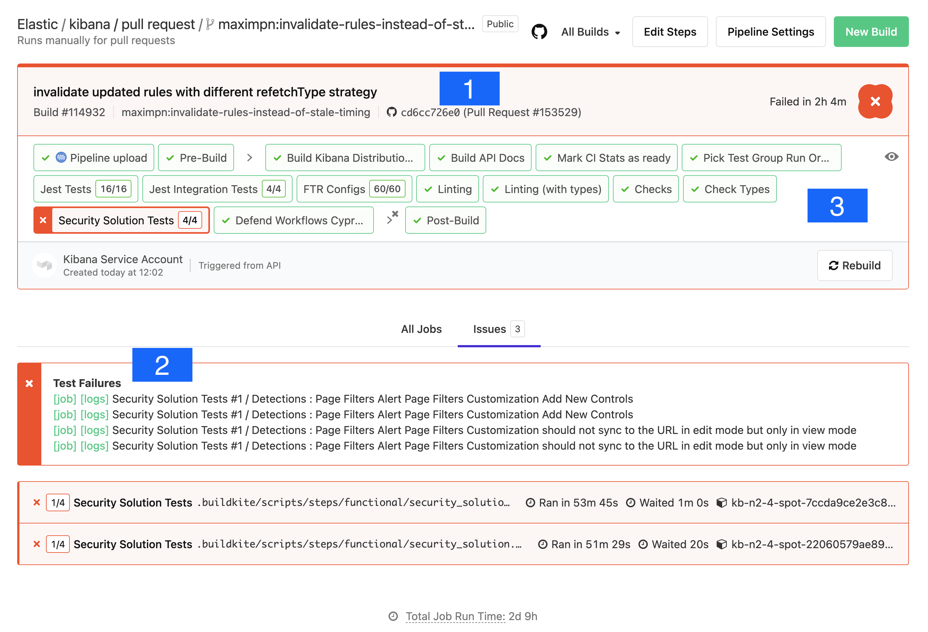

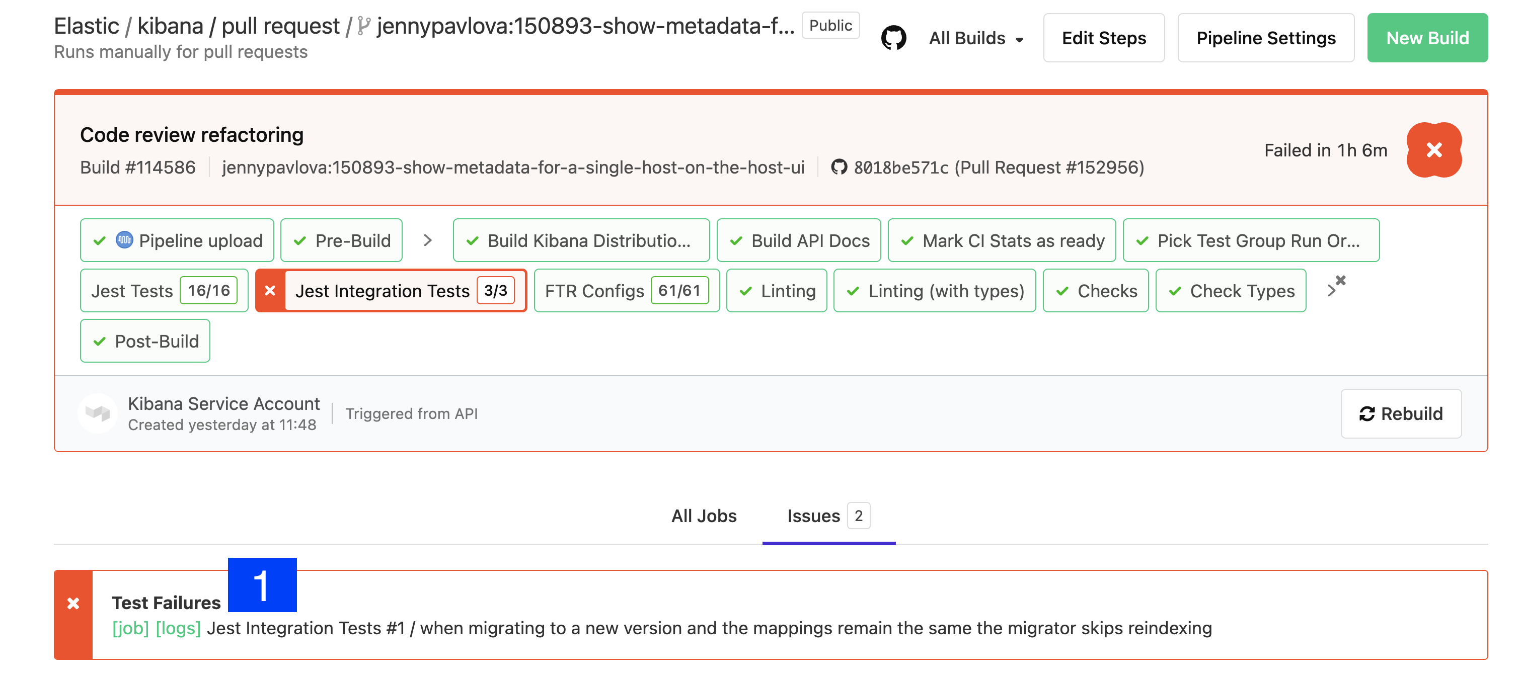

Viewing Job Executions in Kibana
editTo view the results of a job execution in Buildkite, either click the link in the comment left by @elasticmachine or search for the kibana-ci check in the list at the bottom of the PR. This link will take you to the top-level page for the specific job execution that failed.
- Git commit: the git commit that caused this build.
- Test Results: A link to the test results screen, and shortcuts to the logs and jobs of the failed tests. Functional tests capture and store the log output from each specific test, and make it visible at these links.
- Pipeline Steps:: A breakdown of the pipeline that was executed, along with individual log output for each step in the pipeline.

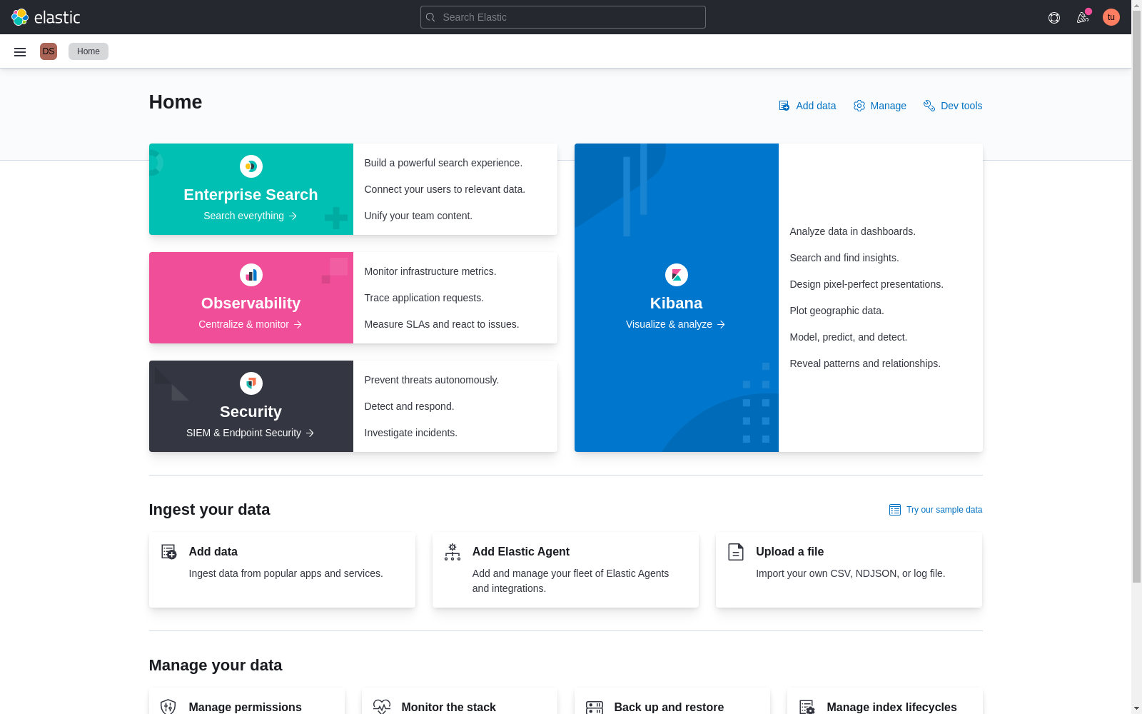

Just above the ✖ fail: line, there is a line info Taking screenshot ... which tells us the name of the screenshot to look for in the Google Cloud Storage (GCS) Upload Report:
Clicking the [Download] link for that png shows this image:

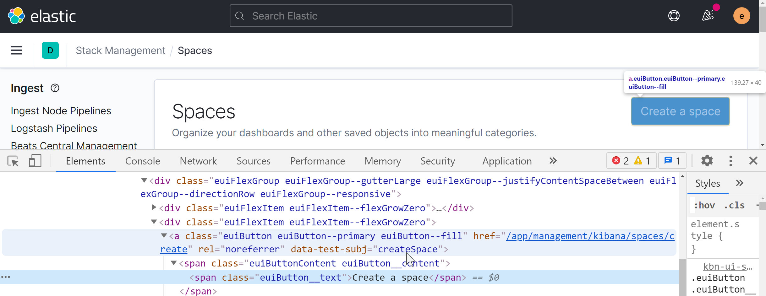

If we use a running Kibana instance and inspect elements, we find that the createSpace data-test-subj attribute is on this button in the Spaces page in Stack Management:
We know the test was not on the correct page to find the element to click. We see in the debug log the repeated attempts to find the element. If we scroll to the start of those repeated attempts, we see that the first thing the test did was this attempt to click on the createSpace element.
