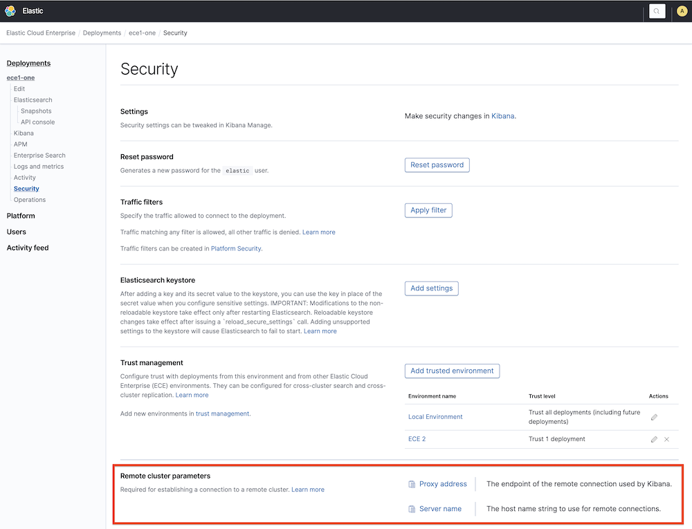

- Proxy Address: This value can be found on the Security page of the Elastic Cloud Enterprise deployment you want to use as a remote.
- Server Name: This value can be found on the Security page of the Elastic Cloud Enterprise deployment you want to use as a remote.

Proxy address: This value can be found on the Security page of the Elastic Cloud Enterprise deployment you want to use as a remote. Also, using the API, this value can be obtained from the elasticsearch resource info, concatenating the fields

Server name: This value can be found on the Security page of the Elastic Cloud Enterprise deployment you want to use as a remote. Also, using the API, this can be obtained from the Elasticsearch resource info field
