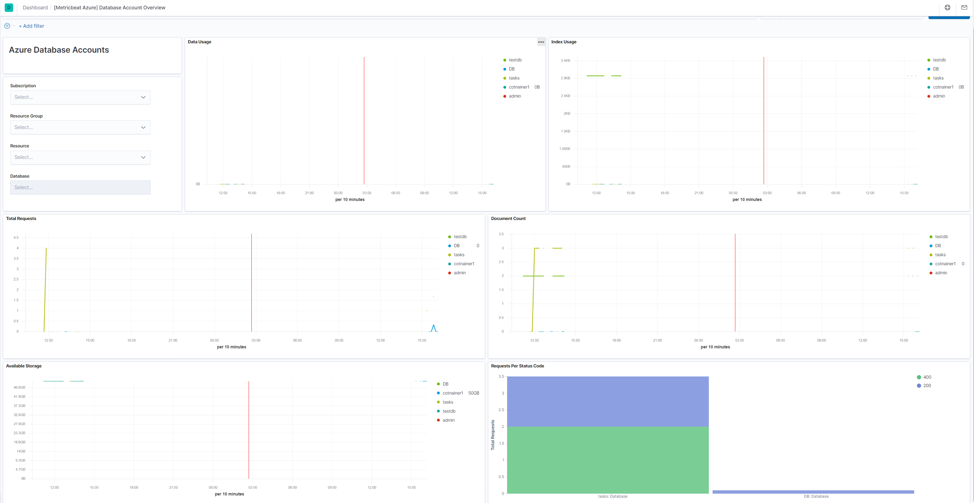

This metricset allows users to retrieve relevant metrics from specified database accounts and comes with a predefined dashboard:
