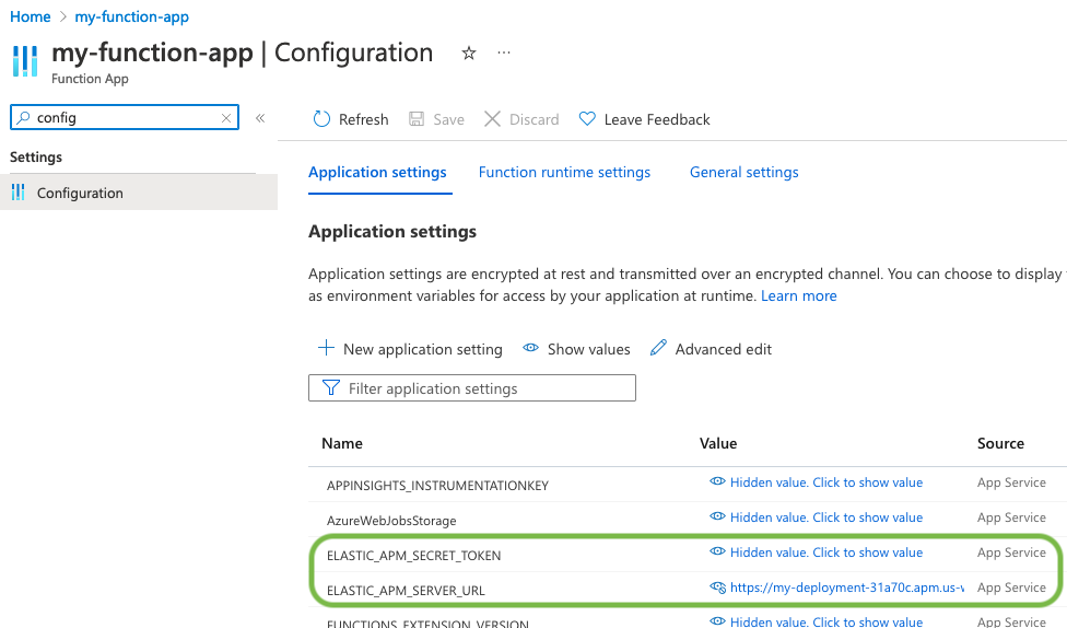

Open Configuration > Application settings for your Function App in the Azure Portal and set:
ELASTIC_APM_SERVER_URL: <your APM server URL from the prerequisites step> ELASTIC_APM_SECRET_TOKEN: <your APM secret token from the prerequisites step>
For example:
![Configuring the APM Agent in the Azure Portal](./images/azure-functions-configuration.png)
