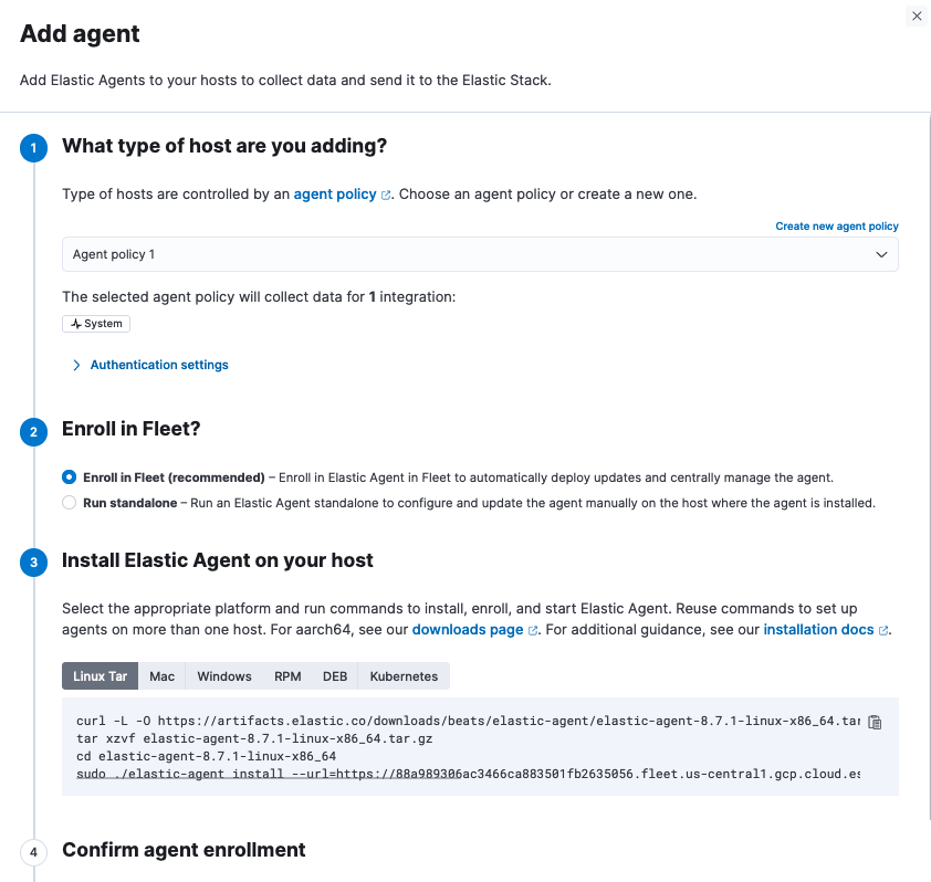

- In Kibana, go to Fleet > Agents, and click Add agent.
In the Add agent flyout, select an existing agent policy or create a new one. If you create a new policy, Fleet generates a new Fleet enrollment token.
For on-premises deployments, you can dedicate a policy to all the agents in the network boundary and configure that policy to include a specific Fleet Server (or a cluster of Fleet Servers).
Read more in Add a Fleet Server to a policy.
- Make sure Enroll in Fleet is selected.
Download, install, and enroll the Elastic Agent on your host by selecting your host operating system and following the Install Elastic Agent on your host step.
If you are enrolling the agent in a Fleet Server that uses your organization’s certificate you must add the
--certificate-authorities
option to the command provided in the in-product instructions. If you do not include the certificate, you will see the following error: "x509: certificate signed by unknown authority".
After about a minute, the agent will enroll in Fleet, download the configuration specified in the agent policy, and start collecting data.

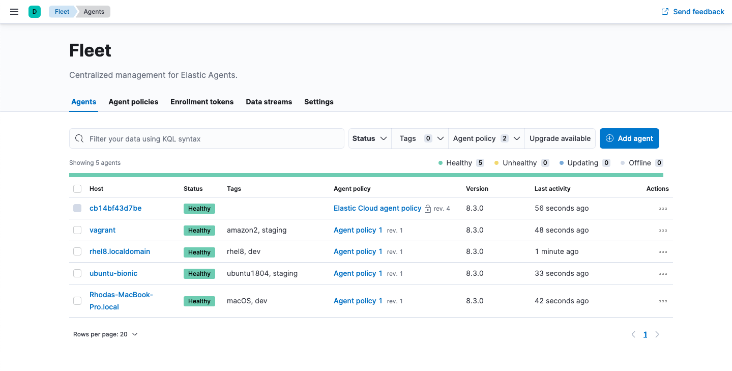

To confirm that Elastic Agent is installed and running, go to the Agents tab in Fleet.
![Fleet showing enrolled agents](images/kibana-fleet-agents.png)
If the status hangs at Enrolling, make sure the elastic-agent
process
is running.
